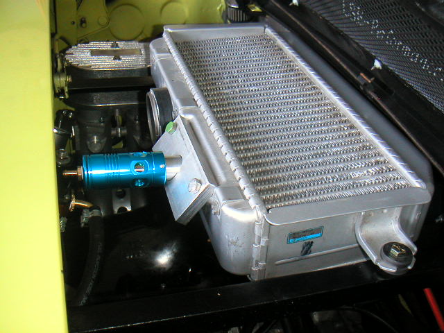

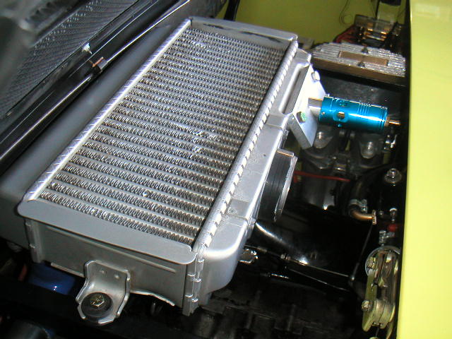

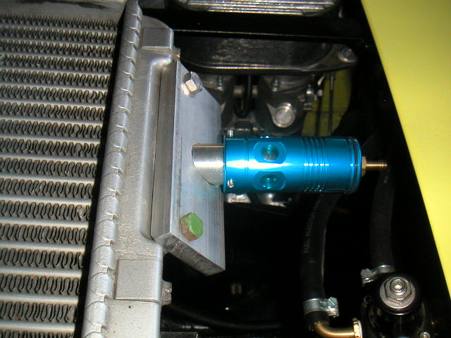

Intercooler mounted and connected to the round to oval adaptors, connected to the ITB hats. With a VNT turbo I shouldn't really need a blow of valve, , but there was a hole in the IC for the factory valve, so now was as good a time as any to make a plate and just put a hole in it for the BOV. I have since trimmed off the plate and finished it off a little better, added some stainless bolts to class it up a little, rather than the parts box bolts in the pictures.
