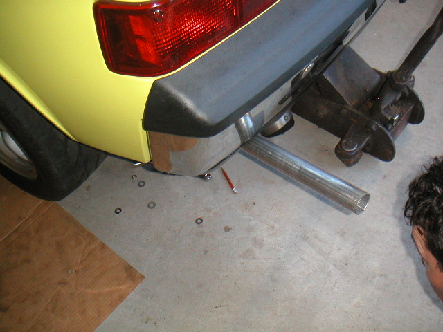

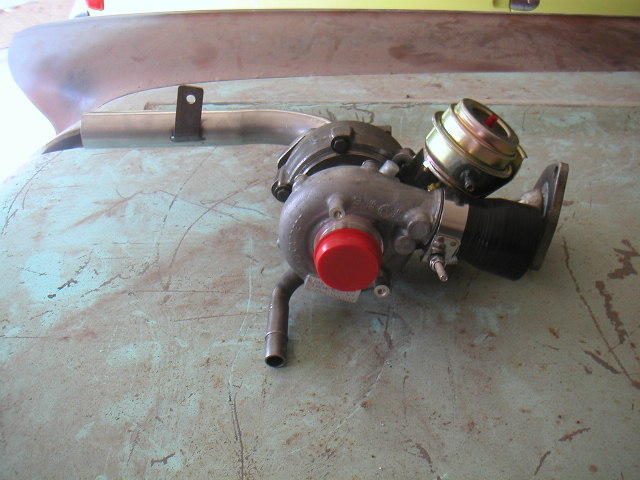

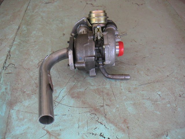

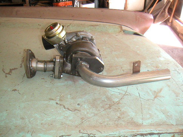

On to the good stuff. Think we'll have to trim off that exhaust just a bit. It should look pretty stealthy when its done. We went thru several versions of the adaptor from the turbo to the header collector. The first one kept the oil in/out of the turbo verticle, for good drainage, but the angles did not favor us, as the turbo ended up 4" off the ground. Before attaching the drain. Not good. We cut, tacked, test fit, and did it again till we had the drain no lower than the engine mounting bar. The oil comes into the turbo at a little bit of an angle, but after consulting with Corky Bell a bit, as the oil drain will be "sucked" dry by the Tildon differential pump I'll be using as a scavenge pump, being off verticle will hopefully be no big deal. Due to the nature of the center section and VNT mechanicals, clocking options for this turbo are limited.
