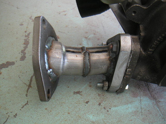

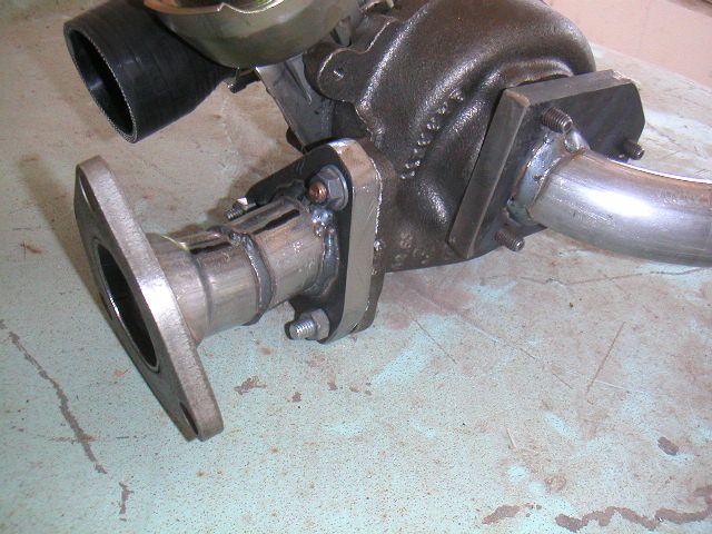

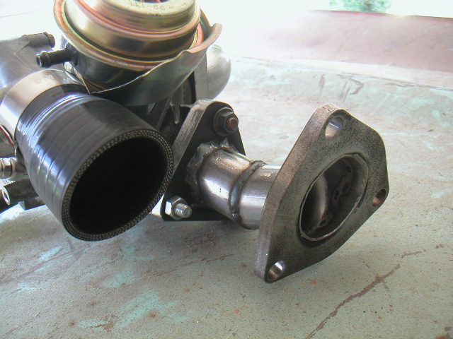

Some close ups of the flanges we had to make, and the final product, which is designed to bolt right in where the supertrapp now resides.
