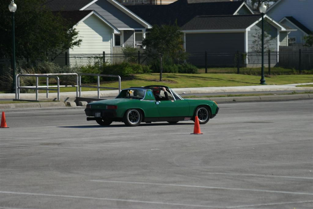

Here are a few shots of the car in action...somebody at the event took several pics of my car!

cha914   lifting the inside front?   Dec 8 2003, 09:32 PM
cha914   turn damit...turn ...   Dec 8 2003, 09:33 PM
cha914   I guess I will leave it as is for now, and get som...   Dec 8 2003, 09:38 PM
