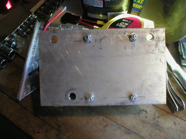

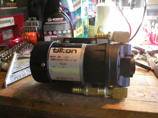

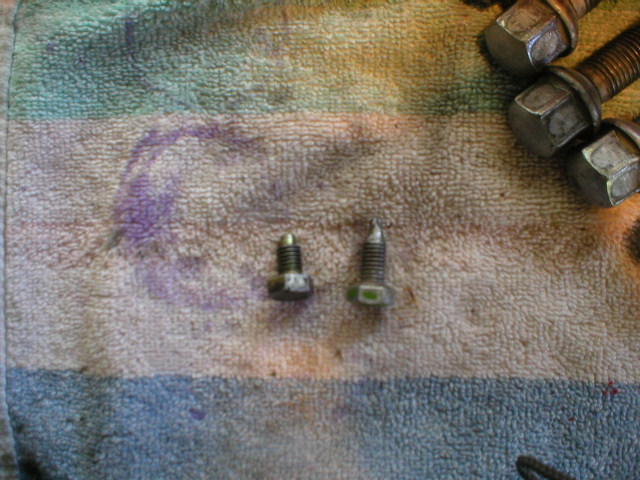

I also got the tildon differential pump (now scavenge pump) mounted. Made the bracket out of a piece of aluminum plate, drilled holes, and done. Well, 1/2 a day later done. I mounted it on the back of the trans where the brace for the factory muffler system would go. I also mounted the bracket thru the pinch bolt for the speedo angle drive, so I had 3 mounting points for the plate. I took another bolt from the box of old 914 bolts, and ground down the end to match the factory bolt, but be longer to accomidate the thickness of the plate. 4 bolts mount the pump to the plate, but be careful where you drill them, as the back of the plate contacts the back of the trans in several spots, and there is no room for the bolt/nut if your hole is in one of these spots.

ottox914   I also got the tildon differential pump (now scave...   Sep 26 2007, 08:46 AM
ottox914   Here are some pics of the pump on the car. I foun...   Sep 26 2007, 08:50 AM
