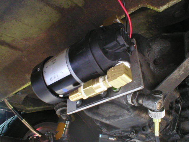

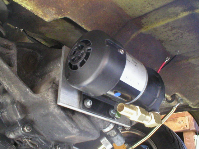

Here are some pics of the pump on the car. I found key switched power in the factory harness. There is a group of 4 wires, 1 black, 1 larger black, 1 white/blue (I think) and one black/purple (tach). The larger black was the coil wire, and after testing with a meter, was found to be hot when the key was on, so I added a 20amp fuse in line, and connected to this location for power.
