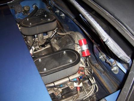

Has anyone else seen this '72 "factory" 3.6 on ebay?

Chuck   1972 Factory 3.6?   Sep 25 2007, 10:42 PM

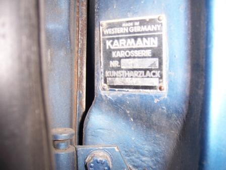

Rusty   Interesting car. VIN is correct for a factory 72 ...   Sep 25 2007, 10:50 PM
Eric_Shea   It's been kicking around for a while now. Was...   Sep 25 2007, 11:34 PM
Dave_Darling   When I saw it in Reno, it did indeed have the corr...   Sep 26 2007, 12:58 AM
Gint   :agree: I have the same pics that Dave took when ...   Sep 26 2007, 07:03 AM

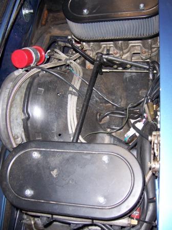

Luke M   No way thats a 3.6 in that car. for 1 it has a mag...   Sep 26 2007, 07:03 AM
Justin Fischer   No way thats a 3.6 in that car. for 1 it has a ma...   Sep 26 2007, 08:25 AM
Chuck   I brought it up because the way the ad is written,...   Sep 26 2007, 09:32 AM
Eric_Shea   :agree: Sounds like they have the VIN resolved an...   Sep 26 2007, 10:30 AM
jaminM3   I think the reason he said "NO" to that ...   Sep 26 2007, 02:11 PM
carr914   About the limit of a Mag case is 2.9 liters. And t...   Sep 26 2007, 03:22 PM
dr914@autoatlanta.com   Just the fact that it is a 72 six makes it worth a...   Sep 26 2007, 03:31 PM
carr914   George, Now that we have broken the ice, I guess I...   Sep 26 2007, 04:06 PM
dr914@autoatlanta.com   Hi T.C. You are dead on the money I AM an origin...   Sep 26 2007, 05:06 PM
SirAndy   note that it isn't twin plug either ... :stir...   Sep 26 2007, 04:51 PM
carr914   But George, How can anyone justify $23,5K and...   Sep 26 2007, 05:21 PM
carr914   I also in my opinion don't believe in price di...   Sep 26 2007, 05:29 PM
dr914@autoatlanta.com   I also in my opinion don't believe in price d...   Sep 26 2007, 06:21 PM

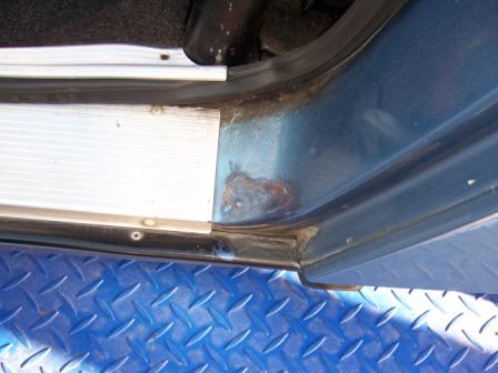

GeorgeRud   That rust coming from the sills seems to spell ...   Sep 26 2007, 09:44 PM
