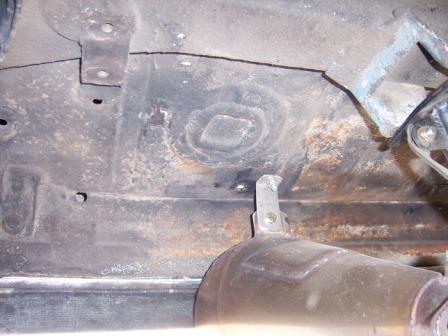

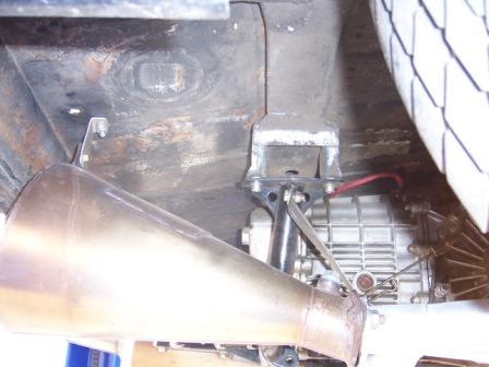

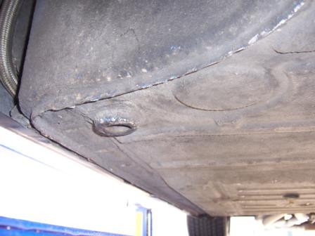

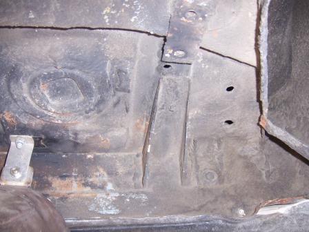

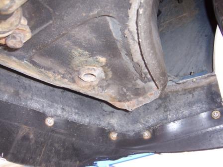

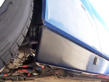

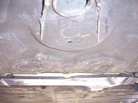

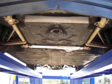

More.
Attached Image Attached Image Attached Image Attached Image Attached Image Attached Image Attached Image Attached Image Attached Image Attached Image

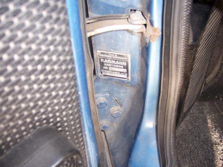

Rusty   Interesting car. VIN is correct for a factory 72 ...   Sep 25 2007, 10:50 PM

Chuck   I brought it up because the way the ad is written,...   Sep 26 2007, 09:32 AM
Eric_Shea   :agree: Sounds like they have the VIN resolved an...   Sep 26 2007, 10:30 AM

Bass Fisher   Kind of a rat if you ask me.   Sep 26 2007, 08:20 PM
Bass Fisher   More.   Sep 26 2007, 08:22 PM
GeorgeRud   That rust coming from the sills seems to spell ...   Sep 26 2007, 09:44 PM
