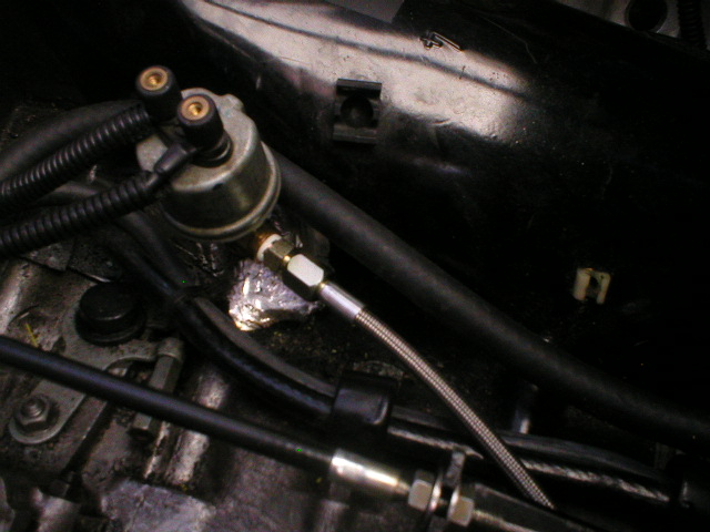

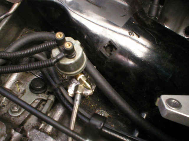

Today got alot of small things buttoned up. Here are some pics of oil lines being installed from the oil sending unit to the turbo.
When I had the motor out for the SDS install, I added a short nipple and "T" fitting to the oil pressure/temp sender, with a plug in the "T" for future use with the turbo.
Next is the line connected.

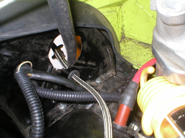

Next is the line going thru the back engine tin, and back to the turbo. There will be hose zip tied around the braded line where it touches anything to protect the hose and whatever it touches. The vaccume line to the VNT actuator will end up sharing the same hole and grommet, so I zip tied the hoses togather in front and in back of the grommet, to prevent any in/out motion.
