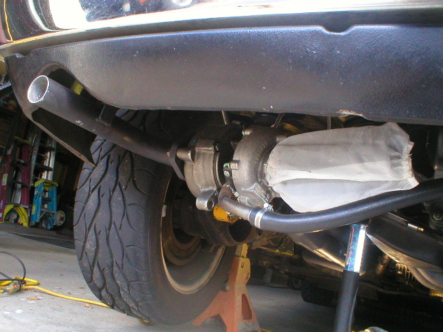

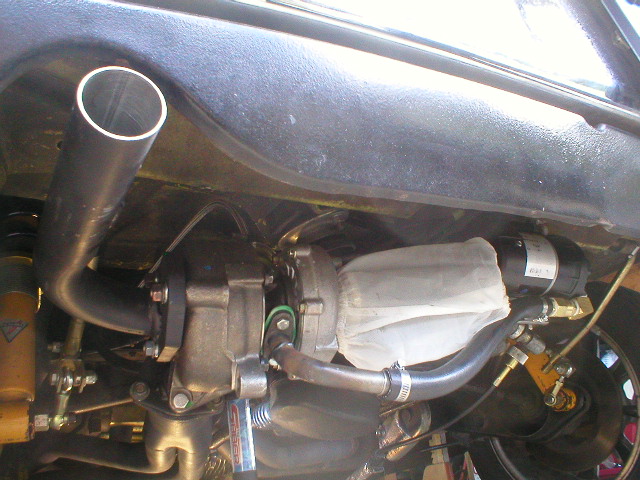

Here's a couple money shots for you- turbo, air cleaner, and tildon pump all installed and ready to go. I suspect I'll be re-doing the turbo drain, as it looks a little lame, but it is no lower than the engine mounting bar. I expect when the car is on the ground, you'll never see anything, except a factory looking little pea shooter exhaust.
