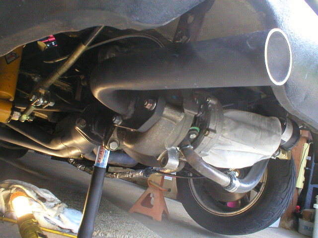

ottox914
post Sep 27 2007, 10:32 PM
The glory that once was.
Posts: 1,302
Joined: 15-December 03
From: Mahtomedi, MN
Member No.: 1,438
One more of the install. I plan to build a 1/2 round shield for the air cleaner. There are a couple of threaded inserts on the turbo, and the shield will just need a couple tabs to easily mount and protect the air cleaner a bit more.
