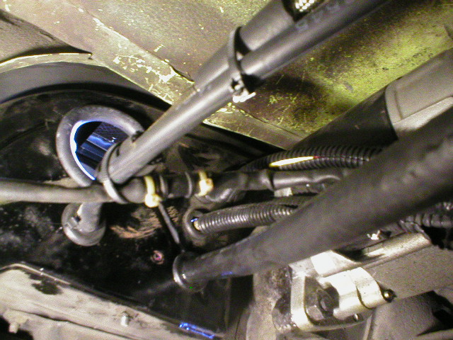

A few more install shots, working on the oil lines.

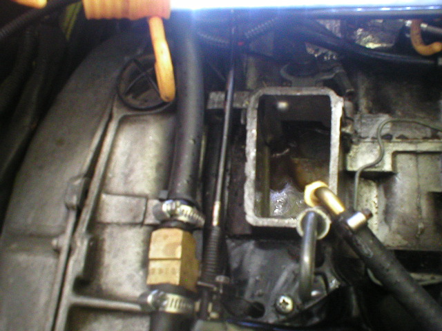

First shot shows the oil supply and vaccume lines to the left, the oil return to the right. Before drilling and putting the line in, I ran a temp line to the oil fill tower, and fired her up! After a the longest 60 seconds ever, oil started flowing! I check under the car, no leaks, so it seems I have a system to the turbo and back. Tomorrow I will be tapping a 3/8 barbed fitting into the oil fill tower, and will use this as the location for the return oil. And yes, I will be careful NOT to get any shavings into the oil system.

Tomorrow- need plugs 1 heat range cooler, make template for final boost line, from turbo to engine area, tap and install the oil return line, new dipstick, re-install intercooler, hook up the SDS, and go for a ride.
