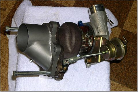

That stinks, I'd check the turbo over really well before deciding it's toast. Look for blades scraping the housings and any internal contact. ANY bearing noises or not perfectly smooth spots while turning would be highly suspect!
I'd also pressure test both intake and exhaust systems for ANY leaks - plug up the ends and use some soapy water or Snoop on the joints - like looking for leaks in a tire. You should be able to spot any leaks right away.
OTOH, TD04's are plentiful and cheap. Many guys upgrading their WRX's to bigger units sell their stock ones cheap.
Flanges are also easy to come by - Outback (who for some reason just changed their name to "Outfront") has inexpensive bare steel flanges for inlet and outlet sides:
http://www.outfrontmotorsports.com/homepage.htm
And these guys make a trick discharge flange for better wastegate and exhaust flow (shown in the attached pic):
http://www.ztspeedandfab.com/index.htm
