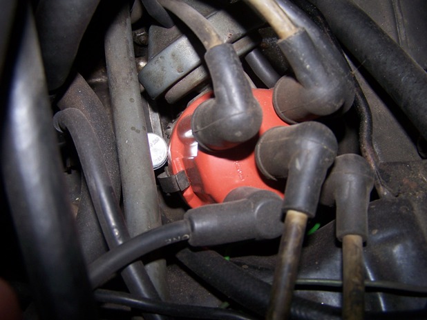

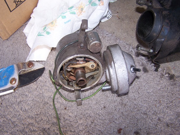

Can some one post a picture of a stock 2.0 distributor in the motor?
I am having trouble with condenser hitting the tin so I can't adjust the timing. I set up drive gear from the book to 12 degrees. |

Hope these help.
J9146 I need help with distributor installation Oct 6 2007, 02:37 PM
jk76.914 Try moving each wire one location left or right, a... Oct 6 2007, 02:45 PM
jasons Your dizzy drive may still not be indexed correctl... Oct 6 2007, 07:32 PM
J9146 Thanks Jerry when I pulled the condenser off I for... Oct 7 2007, 09:14 PM![]() ![]() |
