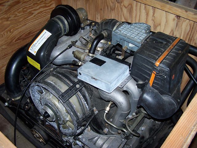

Hey Mike look what came into CAMP today, another 3.2. 4000 miles, stored in this box for 20 years. (IMG:style_emoticons/default/biggrin.gif) Will need a bit of TLC but it is a good start.
I emailed Chuck. CCL Attached image(s)
