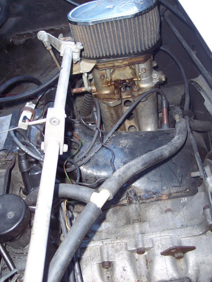

CUMONIWANNARACEU ![]() ![]() ![]() ![]() ![]() Group: Members Posts: 6,811 Joined: 5-January 03 From: Gautier, MS Member No.: 92 |
Engine
Attached thumbnail(s) |
