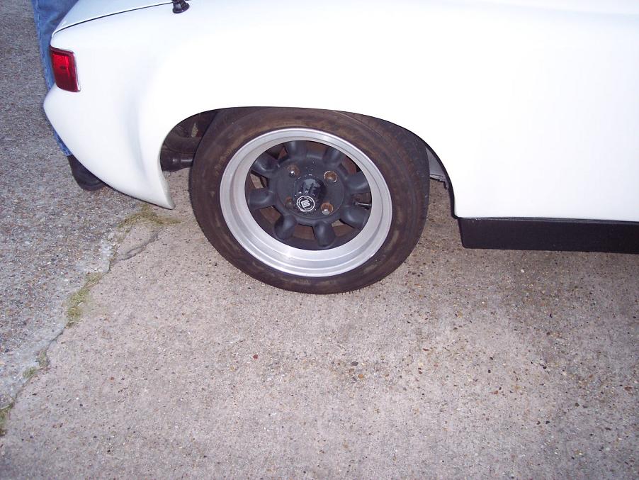

CUMONIWANNARACEU ![]() ![]() ![]() ![]() ![]() Group: Members Posts: 6,811 Joined: 5-January 03 From: Gautier, MS Member No.: 92 |
wheels

Aaron Cox empi 8 spokes are 5.5" wide :)
i stand corre... Oct 11 2007, 10:10 PM
sixnotfour Caroll Shelby "Anaconda" Wheels 15x7 . T... Oct 11 2007, 10:18 PM
Dan (Almaden Valley) those wheels are an old "minilite" knock... Oct 11 2007, 10:24 PM
jd74914
those wheels are an old "minilite" knoc... Oct 11 2007, 11:09 PM
