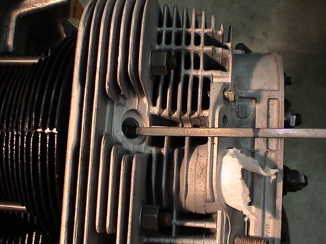

This is pissing me off. Just for the record I did nothing to this motor (some one else did)inside the case. That said I have a 74 2.0 T-IV on an engine stand. I am just about ready to do the tin when I think lets double check the timing and get the distributor on. I start to turn the motor and find TDC for #1 then adjust the valves, then rotate the crank 180 deg. and Holly Crap there is like a 1/8th of an inch play in the intake rocker!! Piston is at or near the bottom. Does this mean what I think it means (cam is not in there right)? Some body, please tell me the obvious thing that I am over looking or doing wrong! (IMG:style_emoticons/default/headbang.gif)

Marks up
Piston up

trojanhorsepower   OK I know that I am not being clear. Brad no one w...   Dec 11 2003, 01:31 PM
trojanhorsepower   Marks up Piston up   Dec 11 2003, 01:34 PM

trojanhorsepower   Rotate 180 deg. CW piston is down intake is slight...   Dec 11 2003, 01:36 PM
Brad Roberts   Pushrods are not sitting in the lifters correctly....   Dec 11 2003, 01:36 PM
Brad Roberts   I rotate the engines over on their side when I dro...   Dec 11 2003, 01:38 PM
trojanhorsepower   damn try again   Dec 11 2003, 01:39 PM
trojanhorsepower   These pics are not helping. I am going back to th...   Dec 11 2003, 01:44 PM
Brad Roberts   Check the push rods............ B   Dec 11 2003, 01:46 PM
trojanhorsepower   I went and pulled the rocker arms and checked the ...   Dec 11 2003, 02:16 PM
