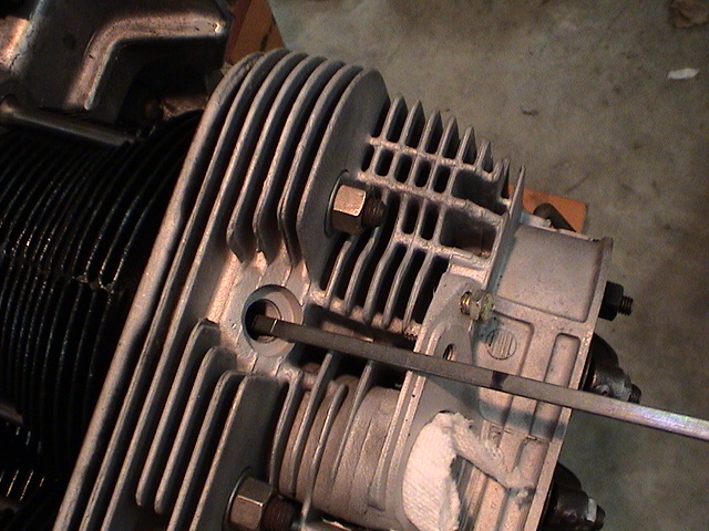

This is pissing me off. Just for the record I did nothing to this motor (some one else did)inside the case. That said I have a 74 2.0 T-IV on an engine stand. I am just about ready to do the tin when I think lets double check the timing and get the distributor on. I start to turn the motor and find TDC for #1 then adjust the valves, then rotate the crank 180 deg. and Holly Crap there is like a 1/8th of an inch play in the intake rocker!! Piston is at or near the bottom. Does this mean what I think it means (cam is not in there right)? Some body, please tell me the obvious thing that I am over looking or doing wrong! (IMG:style_emoticons/default/headbang.gif)

trojanhorsepower   Timing   Dec 9 2003, 01:01 PM
KenH   Make sure you are turning the crank in the proper ...   Dec 9 2003, 01:13 PM
trojanhorsepower   OK I have been turning it CW if that is correct, b...   Dec 9 2003, 01:17 PM
trojanhorsepower   OK turning the motor CW and the intake valve opens...   Dec 9 2003, 07:02 PM
trojanhorsepower   That is really sweat, 58 views and nobody wants to...   Dec 10 2003, 04:57 PM
thesey914
  Dec 11 2003, 12:58 PM
trojanhorsepower   OK I know that I am not being clear. Brad no one w...   Dec 11 2003, 01:31 PM
trojanhorsepower   Marks up Piston up   Dec 11 2003, 01:34 PM
Brad Roberts   Damn.. now I need to leave...DOH! B   Dec 11 2003, 01:34 PM
trojanhorsepower   Rotate 180 deg. CW piston is down intake is slight...   Dec 11 2003, 01:36 PM
Brad Roberts   Pushrods are not sitting in the lifters correctly....   Dec 11 2003, 01:36 PM
Brad Roberts   I rotate the engines over on their side when I dro...   Dec 11 2003, 01:38 PM
trojanhorsepower   damn try again   Dec 11 2003, 01:39 PM
trojanhorsepower   These pics are not helping. I am going back to th...   Dec 11 2003, 01:44 PM
Brad Roberts   Check the push rods............ B   Dec 11 2003, 01:46 PM
trojanhorsepower   I went and pulled the rocker arms and checked the ...   Dec 11 2003, 02:16 PM
Jake Raby   Sounds like you are starting at "overlap" not at "...   Dec 11 2003, 02:19 PM
Brad Roberts   CW facing the fan or CW facing the flywheel ? B   Dec 11 2003, 02:19 PM
trojanhorsepower   CW facing the fan   Dec 11 2003, 02:26 PM
Brad Roberts   Correct. It sounds like you are not starting at nu...   Dec 11 2003, 02:30 PM
trojanhorsepower   Brad, Jake Thanks for all the help guys. I will ...   Dec 11 2003, 02:39 PM
Brad Roberts   The fan turns CW while facing it. In the car.. I g...   Dec 11 2003, 02:42 PM
Jake Raby   We are confusing him.... the engines motion is cl...   Dec 11 2003, 02:53 PM
trojanhorsepower   OK I went out and spun it again looking at #3 Sti...   Dec 11 2003, 02:58 PM
Jake Raby   If that happens turning it CW and all the pushrods...   Dec 11 2003, 04:58 PM
trojanhorsepower   Sorry guys, I was called away form the computer. ...   Dec 11 2003, 09:11 PM
Jake Raby   My number is 706 219 4874. I'm here till 3 Am ...   Dec 11 2003, 09:14 PM
trojanhorsepower   Running home to get cell phone (free long distance...   Dec 11 2003, 09:18 PM
Jake Raby   Try to ring me again...... I heard you beep throug...   Dec 11 2003, 09:50 PM
Brad Roberts   I still say pushrods. b   Dec 12 2003, 12:24 AM
Jake Raby   Told him to triple check them.....   Dec 12 2003, 09:48 AM
Gint   SO?!?! The 914 Soap Opera. Don't kee...   Dec 12 2003, 11:00 AM
trojanhorsepower   I have been away for a while, sorry it has taken m...   Dec 12 2003, 06:04 PM
