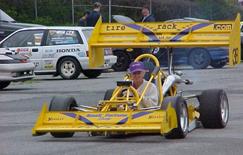

I'm getting in on this thread a little late, but for you non-believers that think wings don't work at low a/x low speed, you are full of horse-hockey. Have a look at some of these cars....
