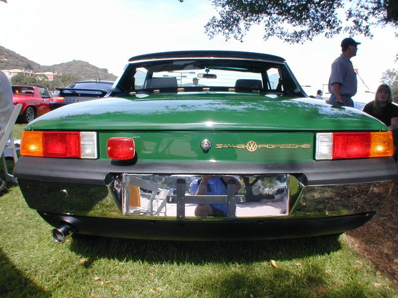

Hi Guys,
I just finished drilling (2) 6mm holes & (1) 3mm hole in by trunk to mount my "Rear Fog Light" factory accessory. I like it, makes my car different from all the others. (IMG:style_emoticons/default/pray.gif)
Here's a few pictures to show details of the U.S.A. issue rear fog lamp I installed. I got a Euro fog lamp assembly from Gustl (thanks Gustl-aka-Wolfgang) & put everything together using the satin black U.S. housing with the Euro lens because I thought it looked better. One of the brackets to mount is still available from Porsche, but the exterior bracket is NLA. The exterior bracket I got from Gustl was a surprise, it's made of stainless steel.
I'll post a number of photo's in a few days showing lots of details & differences. (IMG:style_emoticons/default/popcorn[1].gif) Hope you guys enjoy.

is your car ORIGANALLY euro rear lights. i'm interested in switching to euro's. what is different about the wiring if anything?... it's acured to me the outer orange SHOULDN'T come on for brakes, just turn signal... right?... thats the way it is on newer euro vrs. u.s. spec.ed cars
i've found no answers yet. (IMG:style_emoticons/default/beerchug.gif)
