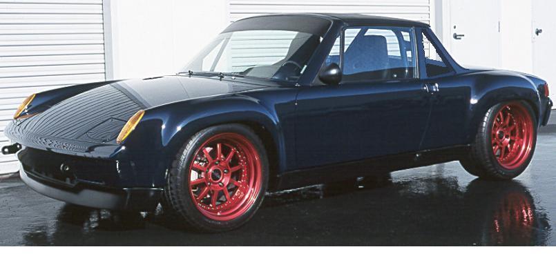

Have you made changes to your 914 body or are you thinking of it?
Here are a number of computer models comparing different body modifications to the 914 and the effects that they have on the cars aerodynamic drag.
http://www.cassidy-online.com/porsche914/aerodynamic_aids
