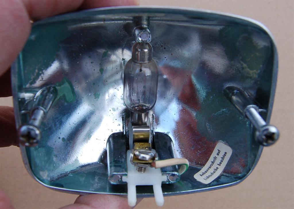

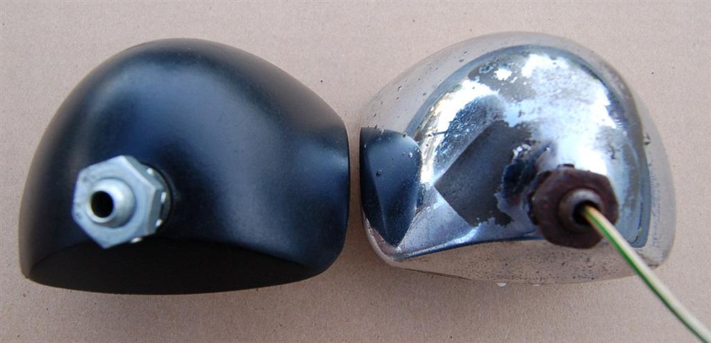

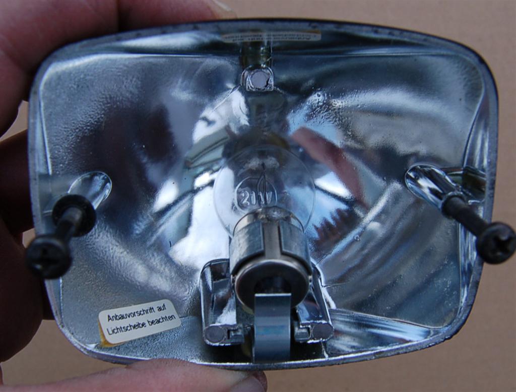

Hi Guys,
I just finished drilling (2) 6mm holes & (1) 3mm hole in by trunk to mount my "Rear Fog Light" factory accessory. I like it, makes my car different from all the others. (IMG:style_emoticons/default/pray.gif)
Here's a few pictures to show details of the U.S.A. issue rear fog lamp I installed. I got a Euro fog lamp assembly from Gustl (thanks Gustl-aka-Wolfgang) & put everything together using the satin black U.S. housing with the Euro lens because I thought it looked better. One of the brackets to mount is still available from Porsche, but the exterior bracket is NLA. The exterior bracket I got from Gustl was a surprise, it's made of stainless steel.
I'll post a number of photo's in a few days showing lots of details & differences. (IMG:style_emoticons/default/popcorn[1].gif) Hope you guys enjoy.

The connection wire into the housing was a short wire about 12" long that threads through the fog light housing then through a little grommett in the sheet metal into the trunk. I was just going to connect the wires at this location, but a simple wire connector would be great. Here's a photo of two fog light housings that might clear up the connection. The euro one (white/green) wire is similiar to the U.S. one that had the wire missing. Hope that helps, but this is just my guess.

Gustl   Note, the U.S. spec housing is satin black & t...   Jun 30 2007, 05:19 PM

Thomas J Bliznik   Differences inside the U.S. & Euro housings T...   Jun 30 2007, 04:09 PM
Thomas J Bliznik   Lens are different. I like the Euro lens & th...   Jun 30 2007, 04:12 PM
