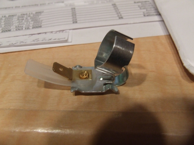

Here is the bulbholder from my lamp.
Brass 0.25" spade is riveted to the positive center contact.
There is no place to connect the ground lead, so it must be body grounded to the chassis. No need for a ground wire.

davep   I only took a quick look at my lamp assembly. Bulb...   Nov 8 2007, 12:25 PM

davep   Here is the bulbholder from my lamp. Brass 0.25...   Nov 8 2007, 08:19 PM

davep   I need help figuring out where to connect the swi...   Nov 11 2007, 09:15 AM

Jeff Bowlsby   Both fog light housing styles only have one pole t...   Nov 11 2007, 10:23 AM
davep   Good point. Then what about a ring connector to go...   Nov 12 2007, 08:47 AM
