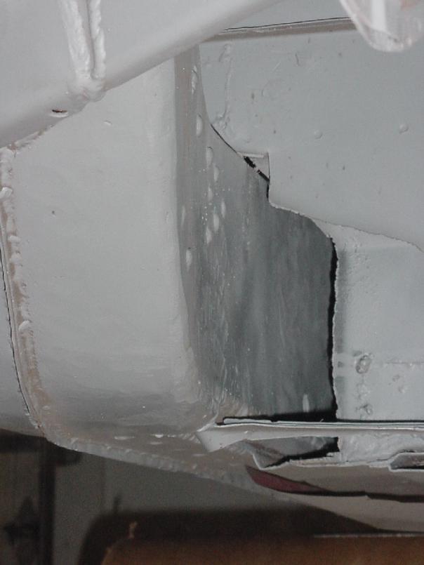

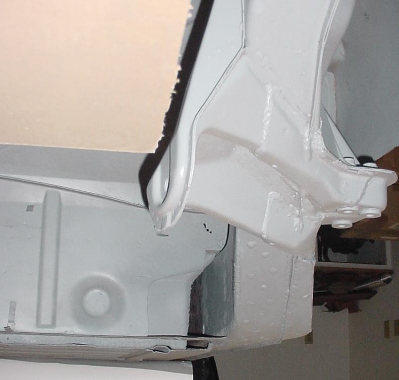

I do weld the perimeter fully after I have the rosette holes all welded up. I haven't had a door gap issue with installing these inner reinforcements. If you go slowly and don't try welding the whole seam as one pass, you shouldn't have the warpage.
I weld the perimeter to:
A. Keep moisture out
B. It looks better
P.S. My latest version penetrates the lower firewall and extends up the long all the way to the inner suspension console.
