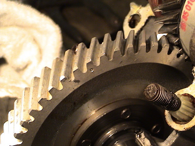

Well I took the case apart (will post pics if my home internet ever starts to work). I found the timing marks on the crank right away, but I had to look and look to find it on the cam. Finaly found it.... on the back of the gear!? WTF
If you follow the tooth the mark was on it was close, but not right. Surely these gears are not meant to be reversable? Also what is that little nub on the end (by the flywheel) of the crank? Should it be centered? The saga continues -Pete |

Back of cam
