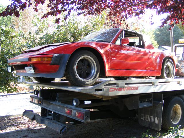

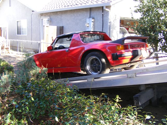

The buyer finally picked up my 25+ year project. He has several 914 V8's so it's in good hands.
It was my first "neo914" by updating the 70's body to 80's "turbo" styling and converting the engine. I'll always remember the award from a Salinas Street Rodder's show in '93 and participating at my first xcross at WCC'04. My club ID was "Jaiderenegadesimpson V8 914" because of all different components I had.
I'll still get seat pinning rides in Harry's beast and eventually Chris Julian's super Ultima to relive the sound and feel of the V8...
