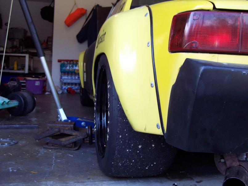

15 x 10 wheel and a 22 x 9.5 x 15 Hoosier slick PERIOD no bigger
I got my new wheels for the rear in Saturday. Diamond Racing made me a custom set in 6 days with shipping. Backspace is 5.75" and that's all that matters. 19 lbs and $295.00 for the pair shipped.

ain't this sexy...............

McMark   That is TIGHT! Both in the teenage dialect, a...   Nov 19 2007, 01:43 PM
nocones   Dang. Looks nice. I know you're an observant ...   Nov 19 2007, 02:36 PM
jhadler   Hey Joe, I'm curious to hear how close the in...   Nov 19 2007, 03:41 PM
Joe Ricard   Right now I am worried about ripping the suspensio...   Nov 19 2007, 03:41 PM
Krieger914   Your immediate concern should be that rusty old sc...   Nov 19 2007, 06:56 PM
Joe Ricard   That rusty old scissor lift works like a champ to ...   Nov 19 2007, 07:09 PM
jhadler   Joe, There are a number of people here in my regi...   Nov 19 2007, 10:03 PM
jaybird840   Well, it looks like the race is on!! Alth...   Nov 19 2007, 10:28 PM
Joe Ricard   Fiberglass GT flares are held on with large head p...   Nov 20 2007, 05:54 AM
chris914   Fiberglass GT flares are held on with large head ...   Nov 20 2007, 09:13 PM
crash914   I would worry about sidewall flex....   Nov 20 2007, 06:31 AM
Joe Ricard   Shouldn't be too much as this is the size rim ...   Nov 20 2007, 07:23 AM
boostedte37   That lookes nasty :headbanger:   Nov 20 2007, 12:44 PM
Joe Ricard   2 years ago I did a thread on it. There are pics...   Nov 21 2007, 07:13 AM
Aaron Cox   tell me more about your afco? rear shocks.... inv...   Nov 21 2007, 04:41 PM
flesburg   We use 245-45 16s on our DE car. We cannot go wide...   Nov 21 2007, 07:47 PM
woobn8r   A 245 should be around 9.6" wide, a 255 about...   Nov 21 2007, 11:18 PM
