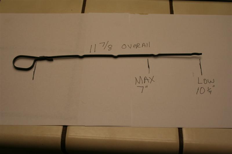

OK guys, now this turned interesting......My overall length is 11 7/8. Now that we have some differences and different shape dip sticks, I need more measurements.
Make sure that you have an original tank\neck and original stick and not aftermarket.
Need:
Overall length
Bottom of loop to full mark
Bottom of loop to add mark
Here is a pic. of what I have. No guarantee it's original (why I am checking)
PeeGreen 914

QUOTE(PRS914-6 @ Nov 19 2007, 06:49 AM) *
Need:
Overall length
This is exactly what I have. My measurement is the same.

9146986   The critical measurement is from the bottom of the...   Nov 19 2007, 09:05 AM
dr914@autoatlanta.com   The critical measurement is from the bottom of th...   Nov 19 2007, 09:09 AM

9146986   I measured two 6'er dipsticks and they both me...   Nov 19 2007, 06:21 PM
Jeffs9146   As far as I know mine is original!   Nov 19 2007, 07:20 PM
davep   So, Paul S & James, both of yours seem to show...   Nov 19 2007, 09:49 PM
PRS914-6   Can we get a series of dimensions in mm from the ...   Nov 19 2007, 11:08 PM
9146986   The only mark on the "real" ones I have ...   Nov 20 2007, 01:37 AM
