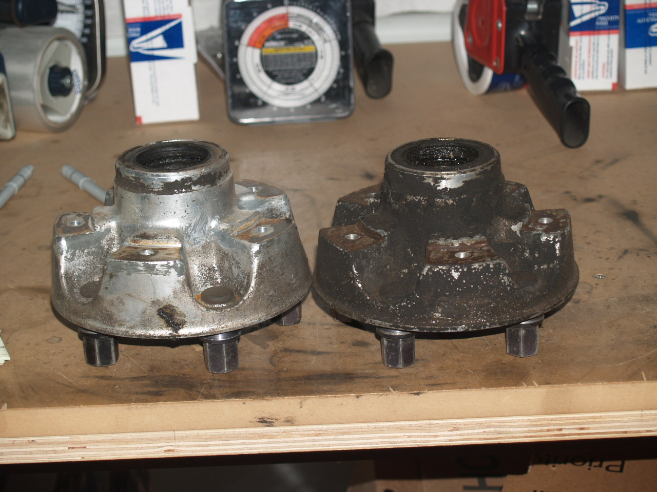

Here is a pic of the 2 hubs. is the thinner one from an early car. Anyone know the years for the 2 of these??

QUOTE OK, here is a pic, same right and left just turned over. The hub on the left seems to be the later hub. The right hub is probably for a solid rotor 911. The 901 part of the number is the 911 part number. I'm sure you all know the story about Peugeot and the x0x zero in the middle issue... The 341 means it's a front end part. If the 065 comes in as a 356 piece, it would be for the last year and they began using the 911 parts on them to make them 5-lug disc brake cars. This will be your solid rotor hub. |

914Sixer The hub on the right is from an early non vented c... Nov 20 2007, 07:46 AM
Eric_Shea
More than likely the other way around.
The th... Nov 20 2007, 10:22 AM
911quest
The t... Nov 20 2007, 02:53 PM
hwgunner OK, I hate cleanning but did it anyway to get the ... Nov 21 2007, 11:16 AM
Eric_Shea I can't help with a PET at this time but... I ... Nov 21 2007, 11:22 AM
hwgunner If I turn them upside down from the way they are i... Nov 21 2007, 11:23 AM
hwgunner OK, here is a pic, same right and left just turned... Nov 21 2007, 11:29 AM
914Sixer I will it admit to being ass backward from time to... Nov 21 2007, 01:55 PM
914Sixer 914 Parts book(1985) shows 901.341.065.04 as the 9... Nov 21 2007, 02:03 PM
hwgunner 901.341.065.03 is a late 356 front hub. I can not... Nov 21 2007, 03:39 PM![]() ![]() |
