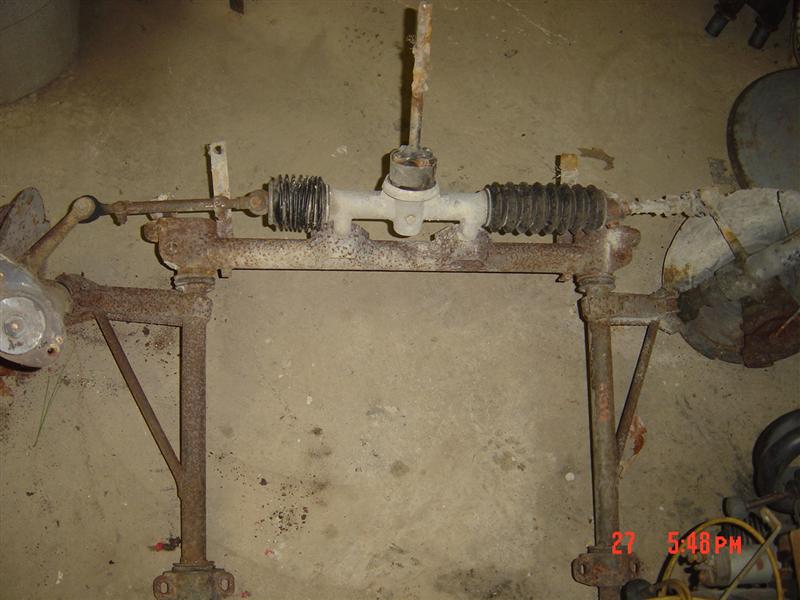

i love porsche   so i have a quick need, i need pictures of the fro...   Nov 26 2007, 07:20 PM
alpha434   935 suspension. Fully adjustable at all points. Mu...   Nov 26 2007, 07:50 PM
scotty b   Here ya go. I also have a complete front end if yo...   Nov 26 2007, 08:07 PM
scotty b   Disassembled   Nov 26 2007, 08:08 PM
