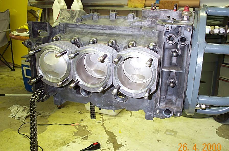

Jake Raby   http://rdtlabs.com/Pictures/4camcarrera/4%20cam%20...   Nov 28 2007, 12:38 PM
