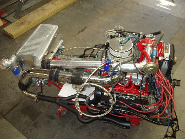

MY TURN!
(IMG:http://images.thesamba.com/vw/gallery/pix/334213.jpg)
Wonder which one makes more power per liter?
Wonder which one makes more power per pound of engine weight?
