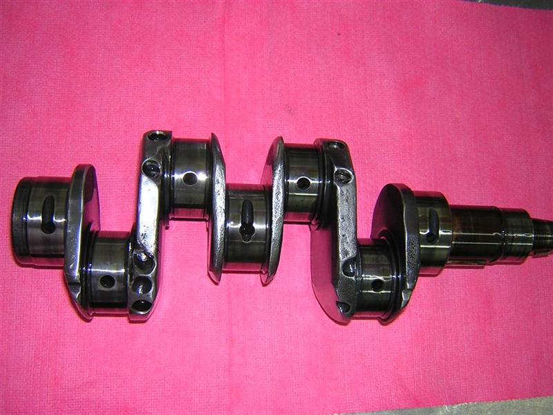

The reason the six needs more mains is because it is LONGER to support two extra cylinders, the longer span creates MORE flex over the span of the crank. This means that more support is needed to keep flex down.
We keep flex down by using stiffer cranks and also by using the largest rod bearing journals possible, this reduces "overlap" between the crank throws and makes for a stronger crank as well. This is why my rod journal of choice is .100 larger in diameter than the stock 2.0 journal size.
With our 4340 chromoly billet cranks flex is also greatly reduced, but not even the stock German cranks had flex issues, we turn these to 9,000 RPM with up to FOUR POUNDS removed from them, one of these has four seasons of peoduction racing under it's belt and still passes magnaflux every time.
Here is a picture of that particular crank

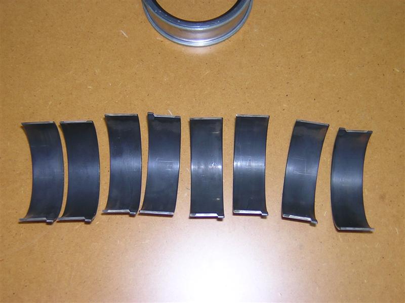

Here are the rod bearings out of that engine after 12 45 minute races, one season of use @ near 180HP from 1832cc

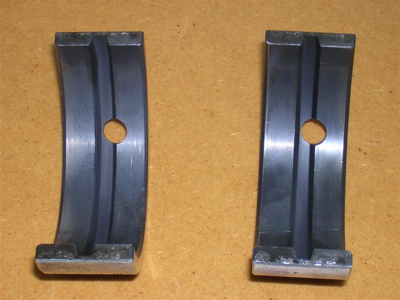

And here are the main bearings
I don't see any signs of wear, do you???? Want a few hundred more examples of reality? I have them because I keep logs on EVERYTHING, nothing like data and proof.
BTW- The TIV actually has 4 main bearings.
