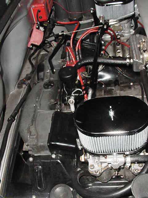

So, I need to order a new throttle cable, which will be run for a carbed motor.
How do I run the cable to the carb link bar? Is there a pulley or channel or something to make the bends easier? What do I need to do to get the leverage to actuate the linkage? Do I need to order a special throttle cable (longer or somehting?)
I'm dumb, pics are helpful. (IMG:style_emoticons/default/huh.gif)

this one works well for me. 3/8"thick stock. the hole for the cable sheath end is countersunk and the cable is nice and secure. if you get the height of the hole right, it's a nice straight pull. my cable is routed thru the engine tin and and a grommit. maybe a terry cable, can't remember.
