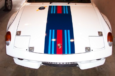

I like the look (and ease of replacement) of the bolted-on GT flare. Does anyone have detailed (up-close) pics of this treatment? What size/number/type of screws or bolts were used.
Please post pics

Here is the tops - kind of a distant pic. More tonight....

Scott Schroeder   Hi All - I unfortunately do not have pics on my of...   Dec 17 2003, 11:12 AM
Scott Schroeder   Here is the tops - kind of a distant pic. More ton...   Dec 17 2003, 11:14 AM
