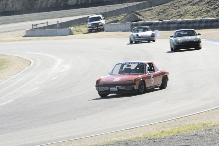

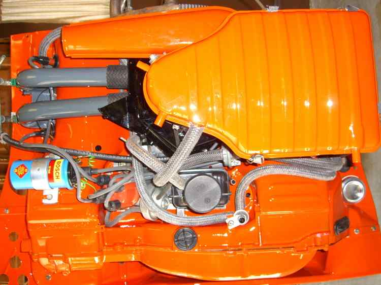

2056 completed in April, '07. AXed ~9 times, 3 days at Laguna Seca and still ticking.
no oil leaks, consumption or other problems. starts everytime on the first try, idles better than it did as a stock 2.0L runs cooler with Jakes 9550 cam, my stock 94mm Mahle cylinders bored out to 96mm, and 96mm KB aluminum pistons. power is definitely an improvement over stock. (IMG:style_emoticons/default/biggrin.gif) considering a 2270 kit in another year or so. anyone thinking about building a 2056 should just go ahead and do it. I was lucky since I had a 2.0L so I did not have to go looking for harnesses, ECUs, tin, etc. I run stock D-jet and have been very happy with it so far. won my PCA AX class running against 987Ss, 986Ss, 993s and 996s, all on sticky tires. Pulled a '65 911 at Laguna with a Jerry Woods 175HP 6. Oh and I won the Improved 914Cup.... not bad for a garage built 2056 in an old Puttputt. (IMG:style_emoticons/default/biggrin.gif) Attached image(s)
