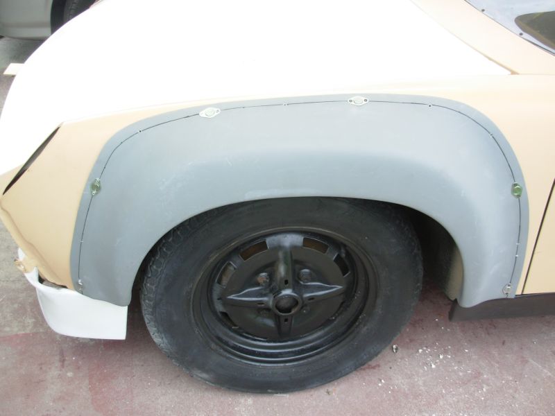

1972 Tangerine, Full Nascar Cage, Chassis stiffining, 2 sets of flairs (will be be Dzus fastening them. Will be be doing Coil-over Fronts & rears, Brembos, Getty 5 Gauge dash and either a 2.7 RS spec or a 2.8 Twin-plug thru a 915. I cant stop (IMG:style_emoticons/default/biggrin.gif) .

carr914 Started Dzus'ing the flares on Jan 1 2008, 07:43 PM

carr914 Well all the flares have the Dzus fittings and whi... Jan 11 2008, 09:38 AM
