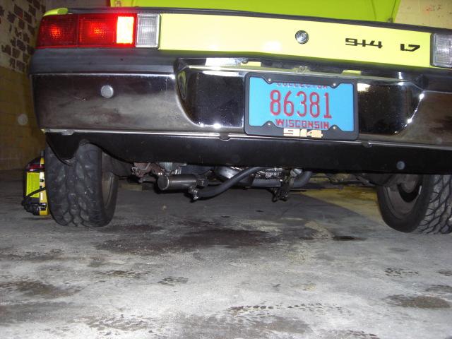

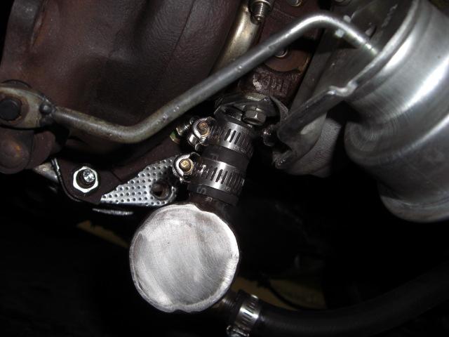

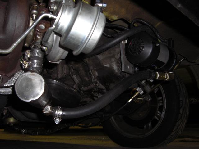

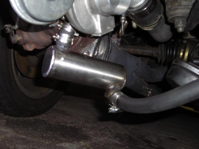

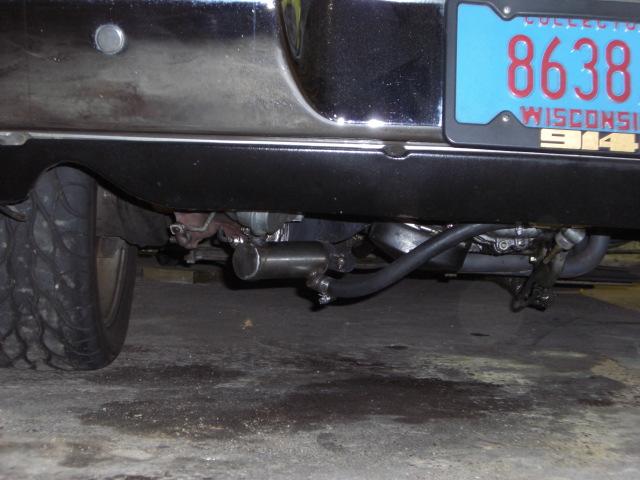

More pics- here are some of the oiling system, there have been plenty of questions about that. I have been consulting with Corky Bell of the Bell engineering group, Inc. He seemed to think the oil pressure of the system was not a problem with this "old school" turbo, but that if I were going with a newer style ball bearing turbo we might need to be a little more careful. Good enough for Corky, good enough for me.
The current configuration, which will be changing, uses a catch can supplied by one of our members who has built a monster turbo'd orange 6cyl. Wonder who that is... The catch can hangs to low. In reality, its no lower than the engine bar, but is hangs below the valance, and the oil return line is low also. Not that I go 4 wheeling with this car, but if I went off at an auto cross, or plugged a cone just the wrong way, I could rip it appart.
Mr. Bell to the rescue again. He seemed to think the catch can would not be needed on a smaller turbo at lower rpms (its not like the stock motor will spin to 7k rpms or anything) such as this one, and advised me that going direct from the turbo oil outlet to the scavenge pump should work fine. So I will be revising the oiling system to do just that, with a very short drain off the turbo, a 90 degree turn right under the turbo, and then attach a line straight to the scavenge pump.
On to the pics-
First is the back of the car, and what you can see, and not see relative to the turbo system. My hopes are to tuck it all up under the car, so all you see is a slightly larger exhaust pipe.
Next is a close up of the back of the car. The current oiling return system is a little low.
Pic of the catch can, which will be going away.
Here is the catch can and pump.
Close up of the drain from the turbo. I'll unclamp the catch can, remove the hose, and braze on a 90 degree fitting to get the oil line tucked up under the car a little better. Better for looks as well as safety- keeping it all attached should I go farming with the car at an auto cross.
