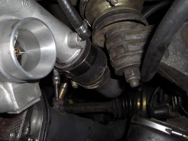

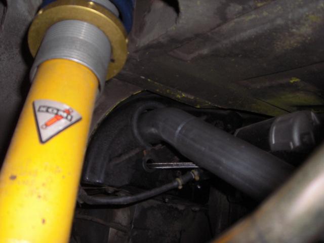

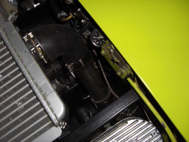

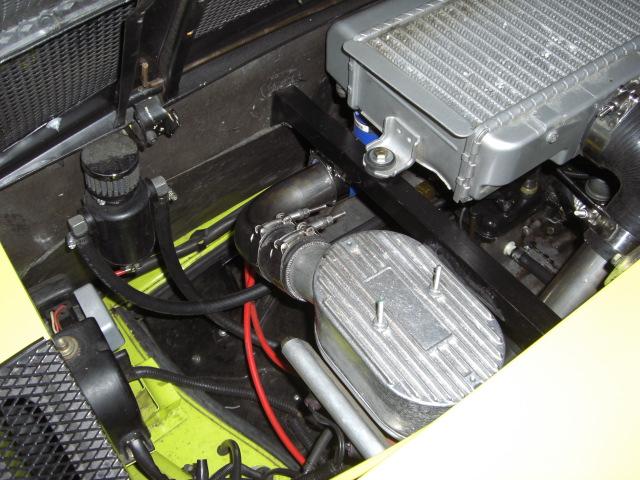

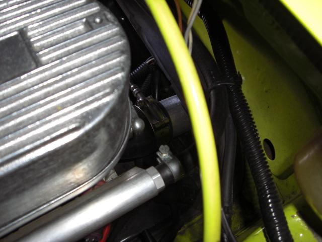

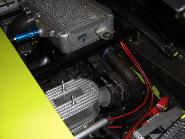

Where does the air go after it enters the turbo? Here's the route:
out of the turbo, up past the starter
thru the back engine tin
into the engine area
up to the intercooler
to the left and right ITB's.
There is a puller style fan coming that will be mounted to the back of the intercooler, and can be turned on/off by the SDS system based on boost present in the system. I plan to also wire in an "always on" switch for auto cross.
