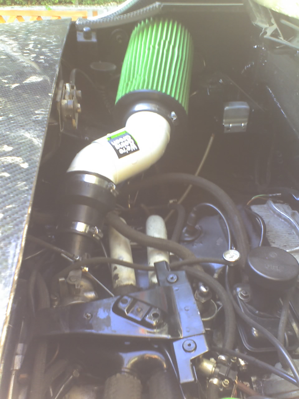

Here's the one I made. Summit had this big GREEN filter on sale, I bought the tubing parts from plumbing department at a hardware store. The key pieces were ABS 45 deg 2.5" (I think) female coupler to press onto the throttle boddy (+hose clamp) and the 2.5->3.5" rubber coupler (heavy!). I drilled into the rubber piece for hose inputs, used the same steel nipple from my OEM elbow. It's a bit louder than the OEM set-up! I have a nice header and race a lot, so I wanted to maximize intake flow. I don't care what anybody says, I think it works and looks cool. (IMG:style_emoticons/default/beerchug.gif)

stateofidleness   mm i like that, any closer pics or details on how ...   Jan 10 2008, 03:14 PM

ChrisNPDrider   Here's another look. I found the rubber couple...   Jan 11 2008, 01:24 PM
