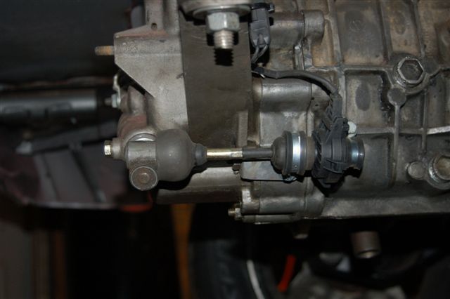

GS Guy   Just a follow up here - in case anyone was holding...   Jan 19 2008, 04:20 PM

BIGKAT_83   I used this for my LS1 V8 conversion for the VSS s...   Jan 19 2008, 07:11 PM

alpha434   What's the thread pattern? Pics?   Jan 20 2008, 08:21 PM
