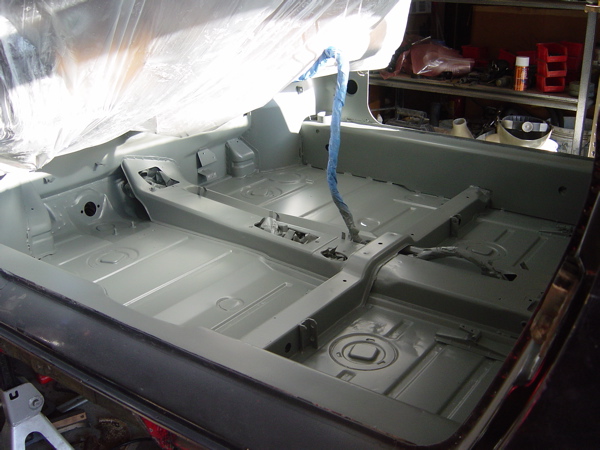

> Progress, Sprayed some primer today
craig downs
post Jan 20 2008, 06:13 PM
Posts: 769
Joined: 25-November 05
From: mira loma ca.
Member No.: 5,189
After a lot of work I finally primed the interior compartment today.
I stripped off the paint
Installed Engman's long stiffener kit,
Redid the speaker hole patch in the fire wall
Made a hand throttle
This is the speaker hole patch before and after

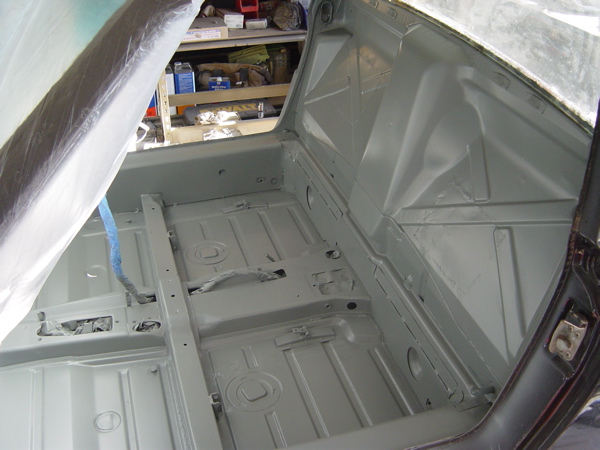

craig downs
post Jan 20 2008, 06:20 PM
Posts: 769
From: mira loma ca.
Member No.: 5,189
And Primed

3d914   Very nice work Craig. What was your choice of prim...   May 25 2008, 02:52 PM
craig downs   Thanks Stephen I used PPG DP40 epoxy primer and ha...   May 25 2008, 11:38 PM
