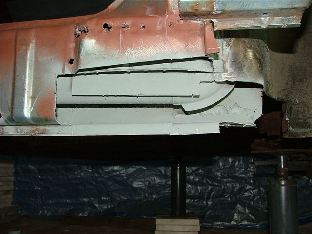

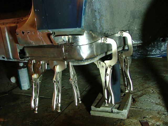

Cut rust out of front of passenger long. Notice there are three layers of metal in this area. A flat piece that is the continuation of the passenger inner footwell that curves around the front wheel then goes straight back down the long for 7 inches or so. The wrongly named inner long covers this, followed by a box like section that continues the door jam down to the bottom of the long.
Could not find the curved inner footwell section anywhere so I hammer formed one on a hardwood mold. I cheated and welded the strip for the bottom pinch weld instead of trying to get the sheet metal to flow in all the directions needed. By carefully tracing the curve of the inner fender well before making my mold it actually fits pretty well. Also made a section to continue the inner most layer of metal down to the bottom of the long.
Weld this up and keep chugging. My goal is to be driving this sucker by my birthday in August. I'm probably dreaming...
