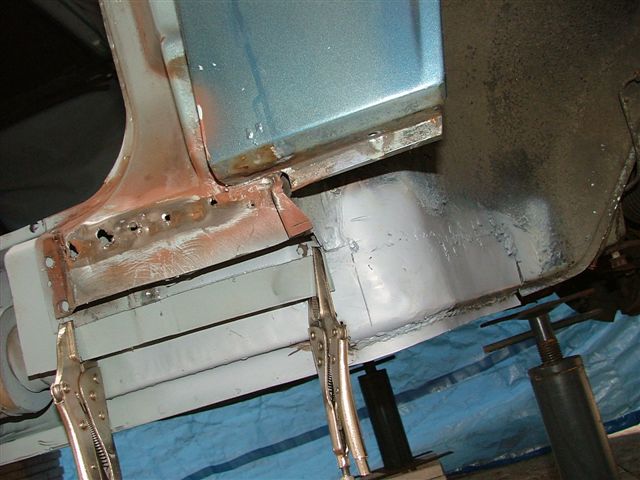

Innermost sheet metal welded in.
Sleeving the inner long patch. You can see the innermost patch has been ground and primed. The hammer formed footwell patch has been welded in, ground (somewhat) and primed. I hate grinding...I love welding.
Section of a Restoration Design inner long panel comes next.
Ready for the hole puncher and some rosette welding.

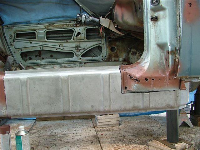

FourBlades   Cut rust out of front of passenger long. Notice t...   Feb 2 2008, 07:56 PM

FourBlades   Welded and cleaned. Nothing better than shiny new...   Feb 2 2008, 08:10 PM
