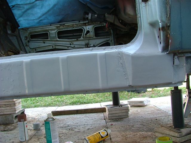

Welded and cleaned. Nothing better than shiny new welds. You can see the rosette welds for the sleeving I did on the rear section of the inner long patch.
Last of the three layers is the box at the bottom of the door jam. I hammer formed this, welded, ground, and primed it. Didn't take any intermediate pictures for some reason.
The work in these last three posts took about all my spare time for the last three weeks. Still some odds and ends to do on this side but I am starting to feel I am getting there. Other side is not nearly as bad at the back, just as bad at the front.
