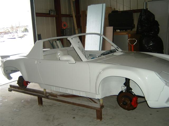

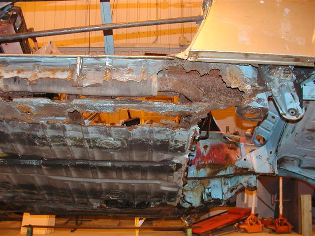

Here are some pictures to give you inspiration. One less than a year ago during the body reconstruction and one current about 3 weeks ago.
As soon as I can figure out how to put a 130 picture PP Presentation on my blog you can see the entire restoration up to today.
