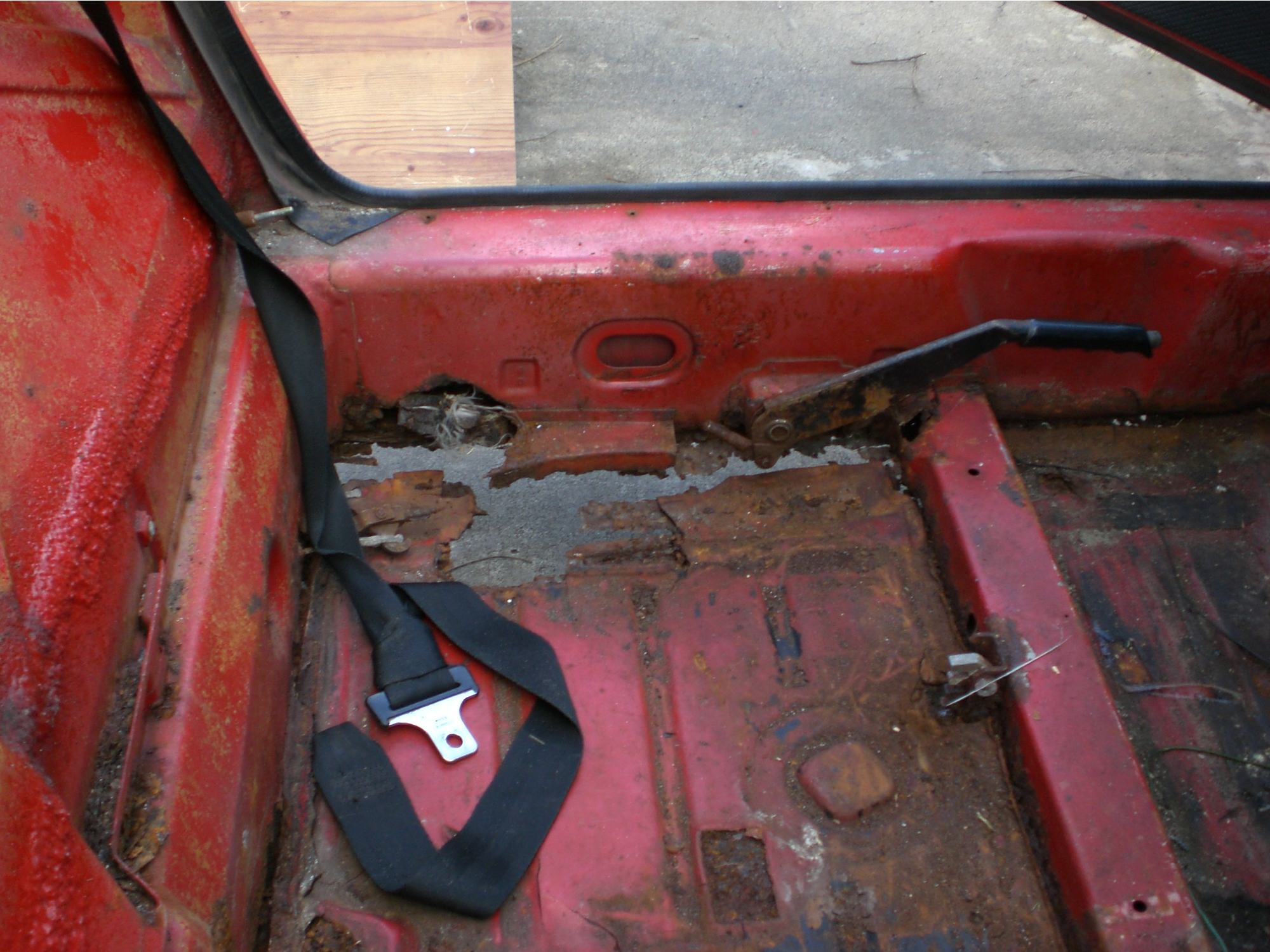

this wasn't the worst area

my928s4   Wow you got your work cut out, is there anything t...   Feb 12 2008, 06:59 PM
rufio0205   i am actually paying a guy to fab the pieces and w...   Feb 12 2008, 07:07 PM
rick 918-S   This is only one of the threads here on the site a...   Feb 12 2008, 11:47 PM
Brando   After seeing that floor rot... I think I'm goi...   Feb 13 2008, 12:45 AM
stateofidleness   what's he chargin you to do that? tryin to get...   Feb 13 2008, 01:14 AM
rufio0205   ...i get the flinstones thing alot. and i'm go...   Feb 13 2008, 07:00 AM
