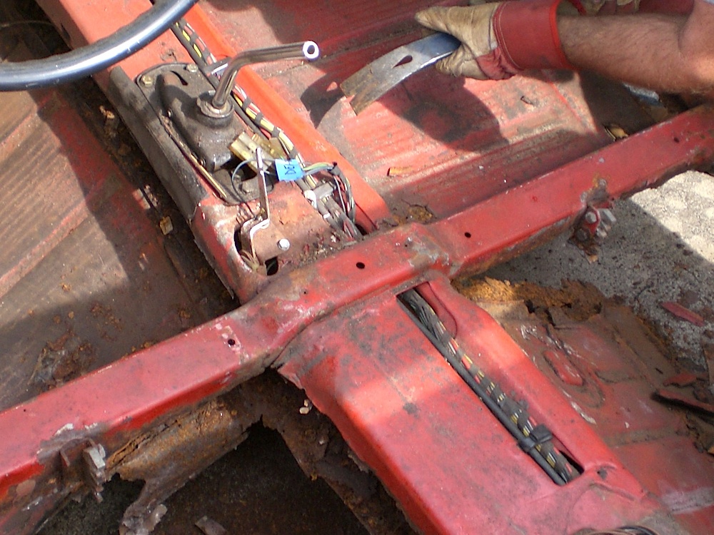

rufio0205   i dont know how to put up photos or i would becaus...   Feb 10 2008, 08:27 PM
rufio0205   this wasn't the worst area   Feb 12 2008, 05:57 PM
rufio0205   ...probably not the best way....   Feb 12 2008, 06:27 PM
rufio0205   partially out   Feb 12 2008, 06:29 PM
rufio0205   dirty work   Feb 12 2008, 06:29 PM
rufio0205   almost done...sorry about all the posts. didnt kno...   Feb 12 2008, 06:31 PM
rufio0205   the floors are out...in my pickup...   Feb 12 2008, 06:32 PM
rufio0205   and lastly before pictures of new floors....   Feb 12 2008, 06:36 PM
rufio0205   and lastly before pictures of new floors....   Feb 12 2008, 06:37 PM
my928s4   Wow you got your work cut out, is there anything t...   Feb 12 2008, 06:59 PM
rufio0205   i am actually paying a guy to fab the pieces and w...   Feb 12 2008, 07:07 PM
