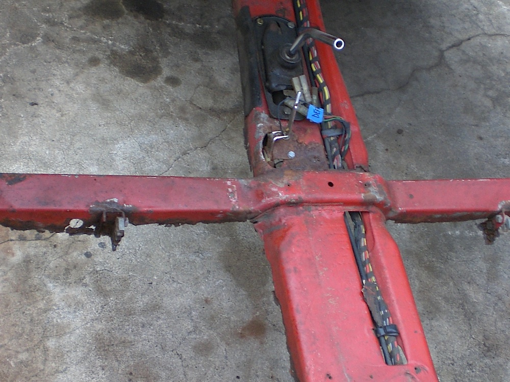

so the floors came out of my '73 2.0 today. i took out the pedal cluster, the gauges in the center console, and the master cylinder came out as well.... now the question is...would it be better to get a 914/6 master cylinder, rebuild mine, or do a big brake up grade - to the 911 calipers and what not.
what did you guys do to make the cockpit a little nicer?
any suggestions?
what would you change about the cockpit?

and lastly before pictures of new floors....

rufio0205   this wasn't the worst area   Feb 12 2008, 05:57 PM

my928s4   Wow you got your work cut out, is there anything t...   Feb 12 2008, 06:59 PM
rufio0205   i am actually paying a guy to fab the pieces and w...   Feb 12 2008, 07:07 PM
